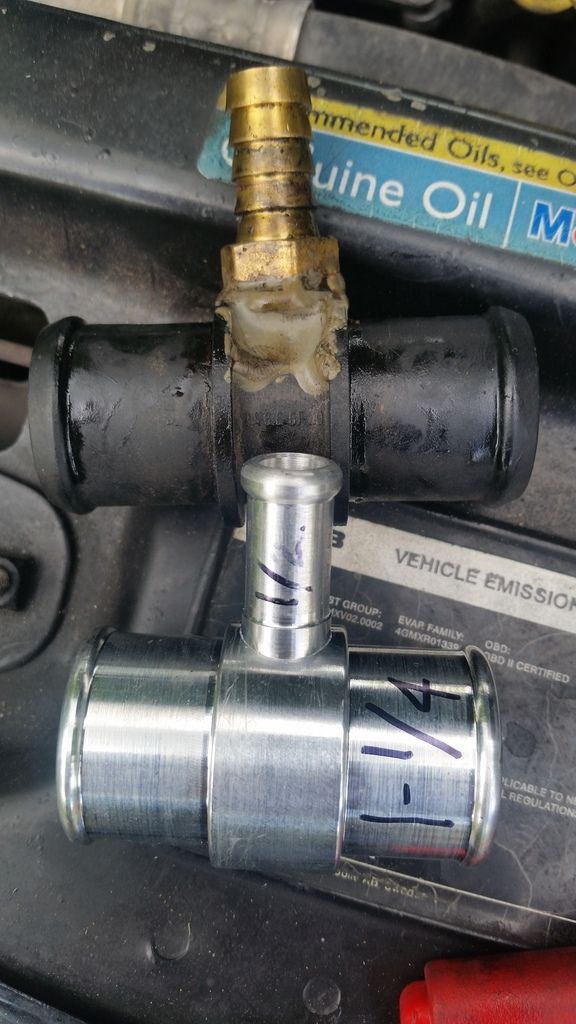

Meanwhile, you may still need the car to get home or to work in the morning. There is an emergency repair using a large brass NPT tee, but the hose ends/clamps barely engage over the ends. I elected to use a barb.
3/8NPT threaded end, 1/2 barb hose end . Do not use 1/2 npt threaded size. This is not the most common size, so don't waste time at typical home improvement store. I chose Ace, but hardware stores in general, are more likely to have it than big box home improvement stores. This requires drilling a hole slightly larger than 9/16 where the broken nipple was. 1/2" drill bit and copious "wallowing", filing, or dremeling, will work. This size will actually bore through part of the tee, but is required to thread the nipple into the tee. If done properly, the nipple will thread and seal fairly well but there will be exposed threads on the side where the plastic was bored through.
Regular (not marine or qwik) JB weld, clean surfaces, and 6-24hr dry time will suffice.
This repair held, but did leak very slightly. Not from the repair, but from crooked hose clamp.

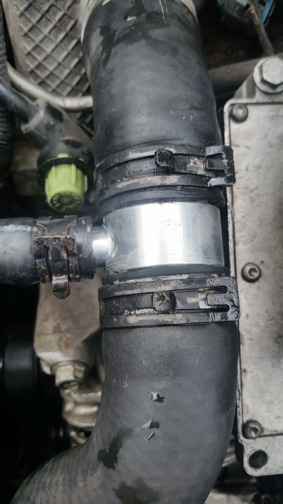

I elected to use the jagsthatrun aluminum tee for $24, as the permanent replacement. As a common problem, this can be ordered by simply entering "saab 9-3" in the size box. Or by specifying "1-1/4x1-1/4x1/2". This part is not an exact replica, but it is a fit and functional replacement.
